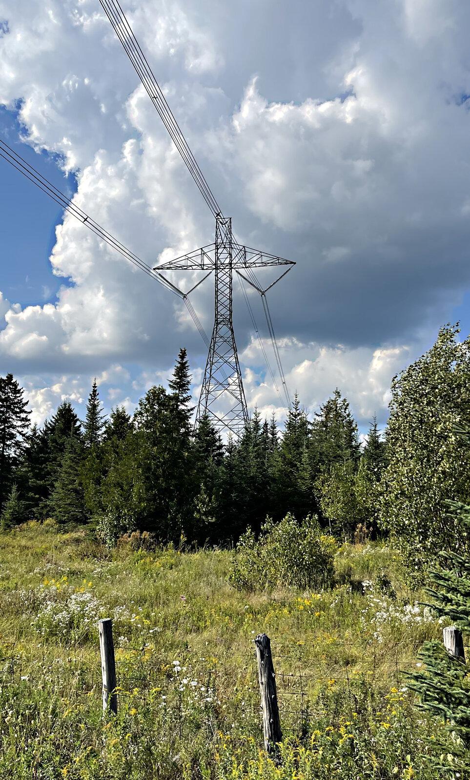

So why am I going on about this? Yesterday we were driving in the country and I spotted this out the window.
Tesla Model 2 The curse of 'white oil': electric vehicles' dirty secret IMG_1646_
Did a double take, swerved and went back to take the picture. No, Mrs did not think I was nuts. She well knows I am. So what's wrong with this picture? Some of you may, from the drift above, already figured that out but I'll bet that very few of you have ever seen a pylon like this one before though you may have seen thousands of normal ones. What's wrong with this picture is that there are only two sets of conductors on it and all the towers you have probably seen have 3 (I had never seen something like this outside of a GE lab and that was over 50 years ago). This is a DC transmission line (Edison must be chuckling in his grave) which transmits 2000 MW at ± 450 kV from James Bay to Boston (with taps for Montreal)..
DC transmission has its own set of problems associated with voltage conversion, conversion from AC to DC and back and switching, of course, and DC lines are rare but reactive currents are eliminated.
