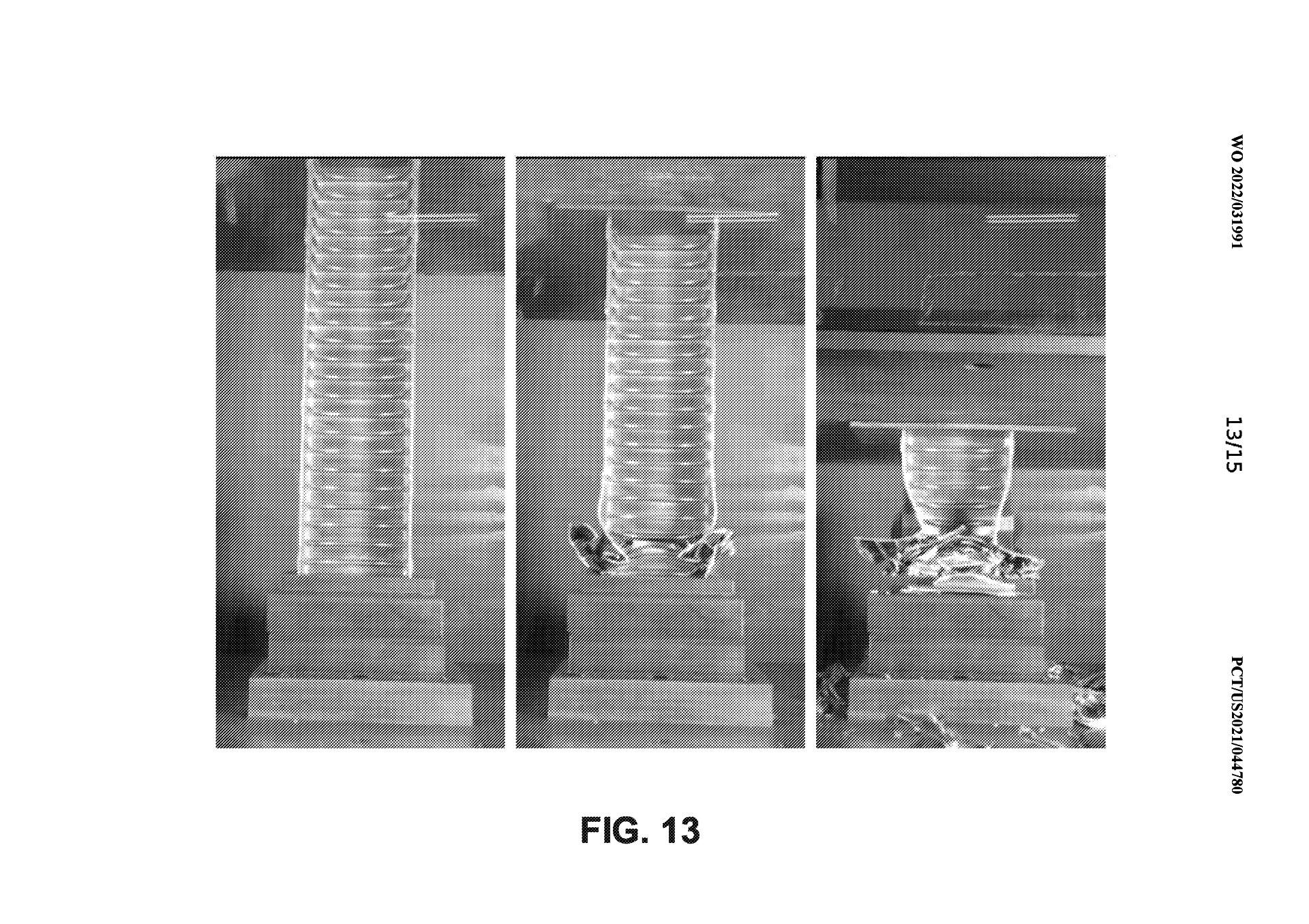

The damage would progress through the stepped 'webbing' as you call it. Each step would absorb a certain amount of force and then the next bit any beyond that, and so on.
So just like with welded assemblies, you cut out the crumpled pieces, and replace them.
It's no different with a gigacast.
Again, it's only repairable if it was designed so, gigacast or welded assembly.
