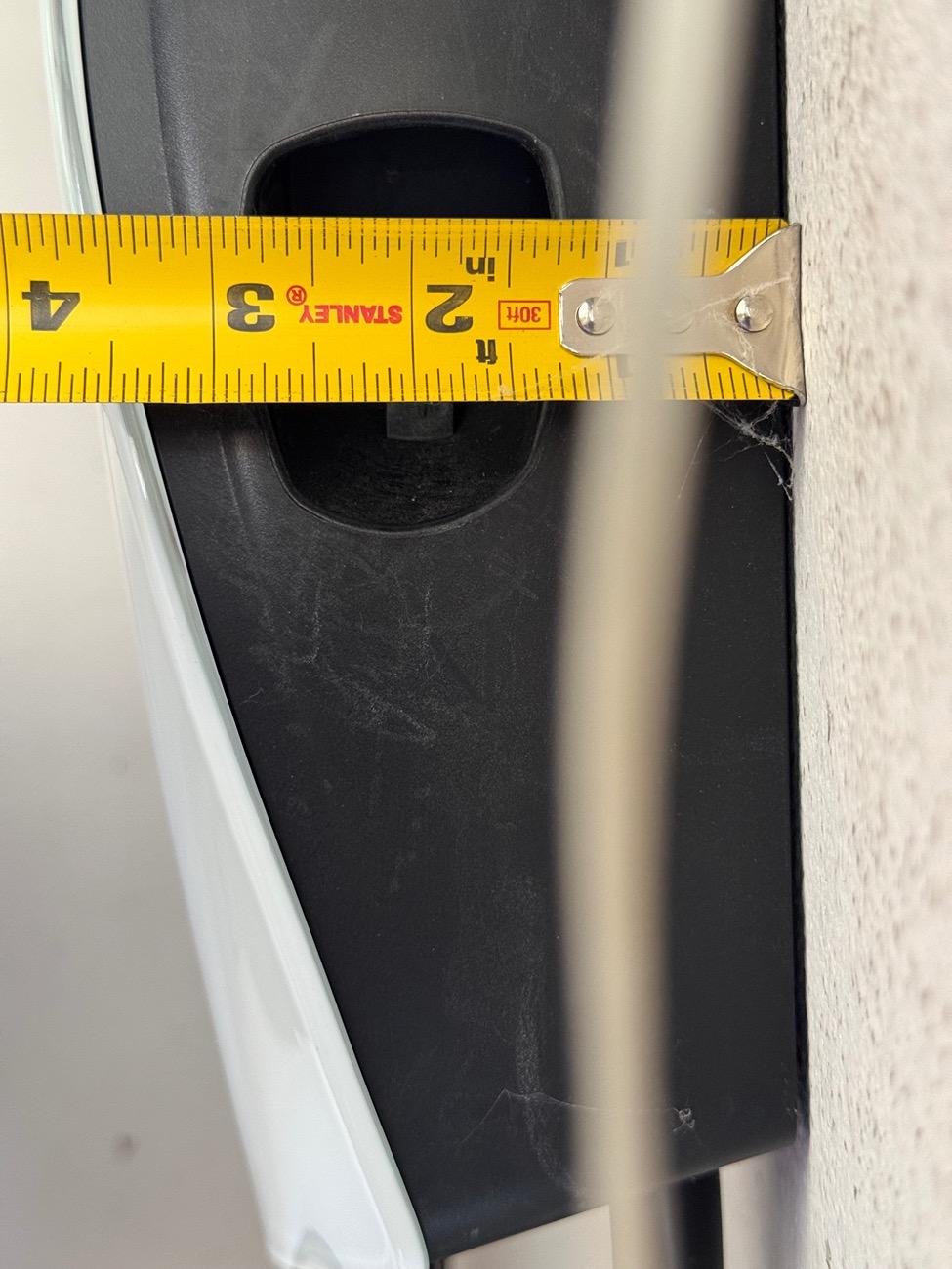

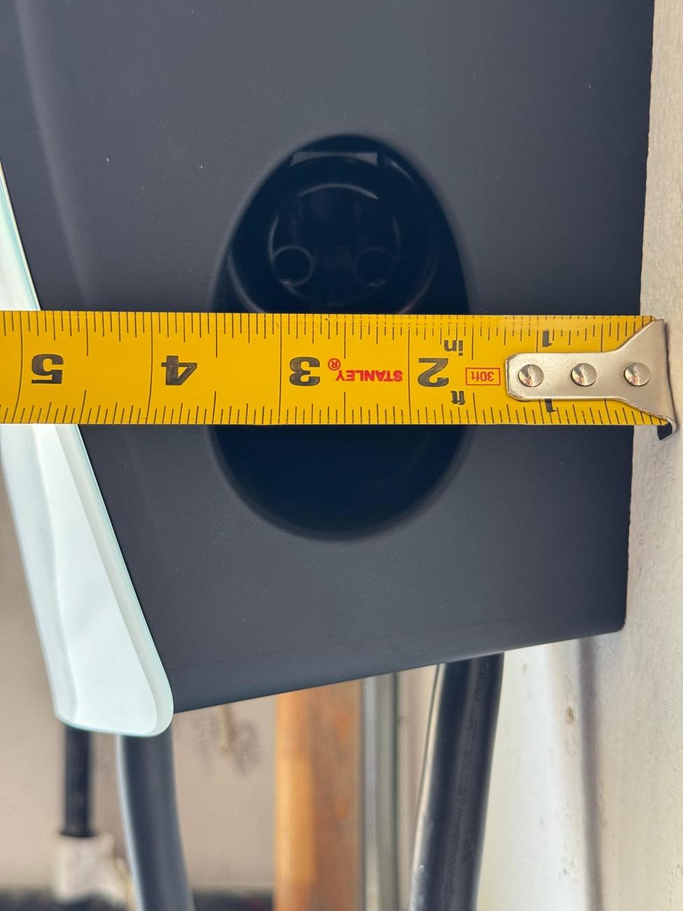

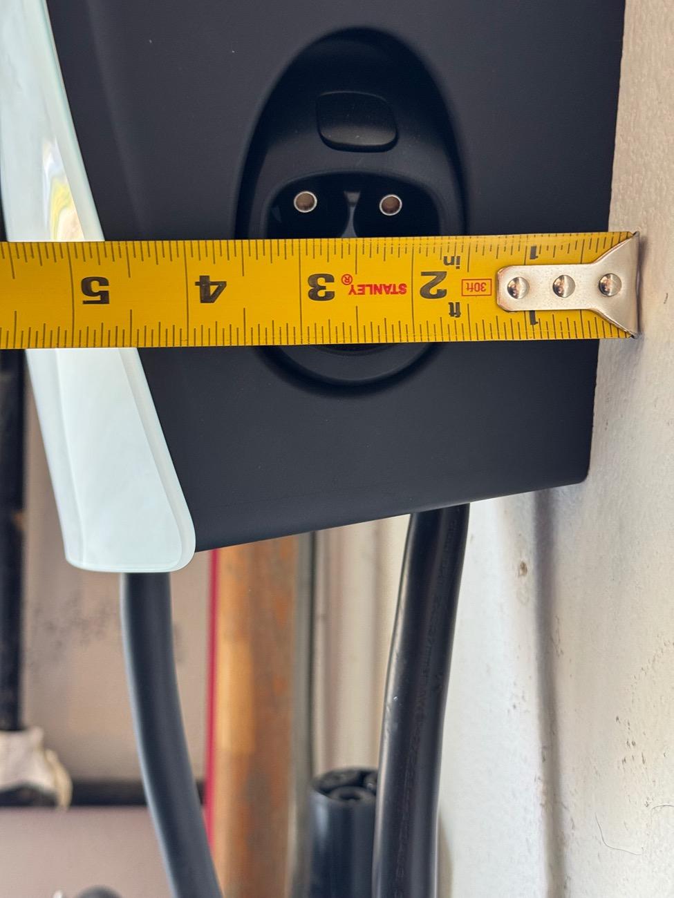

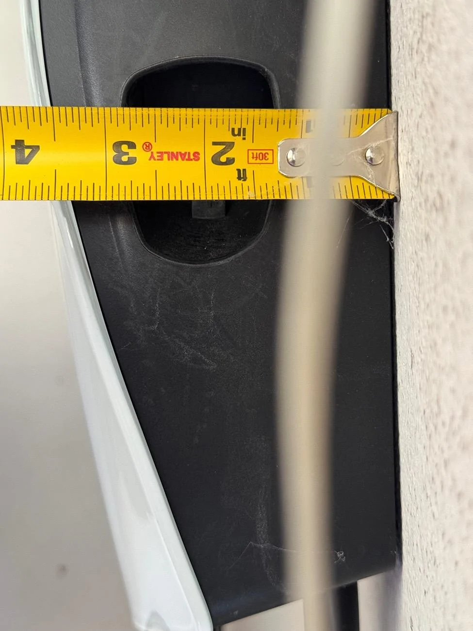

OK, many/most CT owners will be getting the Universal Wall Connector that I referenced above. I'm a big Kickstarter fan and your early bird was down to only three left, so I've signed up for one. I'll have my PowerShare installed by your August estimate so we can work out whether it works or you will be making another model at that time. Thanks - cool idea!Hi Eric,
the UWC 's dimensions are as follows 13.6in H x 6.1in W x 5.9in D while the gen 3 Wall Connector which is what I designed the cover for is 13.6in H x 6.1in W x 4.3in D
I don't have a UWC to check how it's put together. It seems like my stainless steel cover would slip around it just fine, but would leave an uncovered gap at the bottom of the wall connector(closest to the wall).
If there is enough interest, I could potentially make one for the UWC as well.
