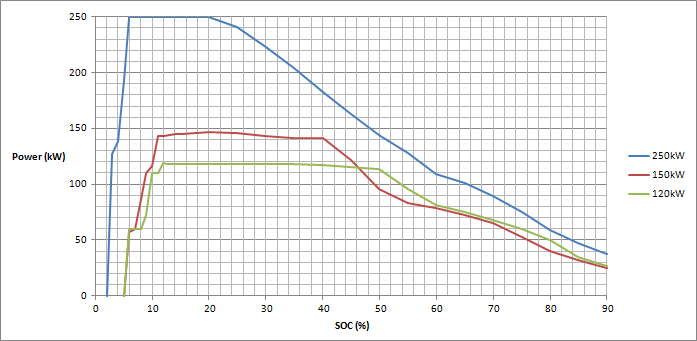

First, I didn’t say average charge speed would be 75 kW. I said half the cars would be charging at 75 kW or less. Thinking on it, that is… probably a bit low. More likely half would be at 100 kW. If you just plug in a destination and follow Tesla’s recommended charging stops, they get you to stops at around 20% and have you leave at a bit below 80% and most stops take 15-20 minutes. At a 250 kW charger, thats when tapering starts and your rate of charge starts going down.I defined my argument as 40x 350kW. Sure that is peak, but it's still pretty impressive? I know they won't all be running flat out, and that is why I said ROI on a poorly utilised setup like that won't be high?

After 5 minutes you are at 50% state of charge and your charge rate is down to 150 kW. After 10 minutes you are at 62% SOC and charging at around 100 kW. After 15 minutes you are at 70% SOC and charging at 75 kW.
I think you get the point. Supercharger stations are not designed to operate at peak capacity continuously. V2 chargers would share 150 kW between them. Every V3 chargers are grouped in 4s and have a similar, but more generous maximum draw which is lower than the peak draw rate. (Numbers are approximate)
Charge curves make this all work; the assumption is that someone on the circuit will be at least halfway through their charge cycle.
Since you never have 40 people roll into an empty station at once, it works.
