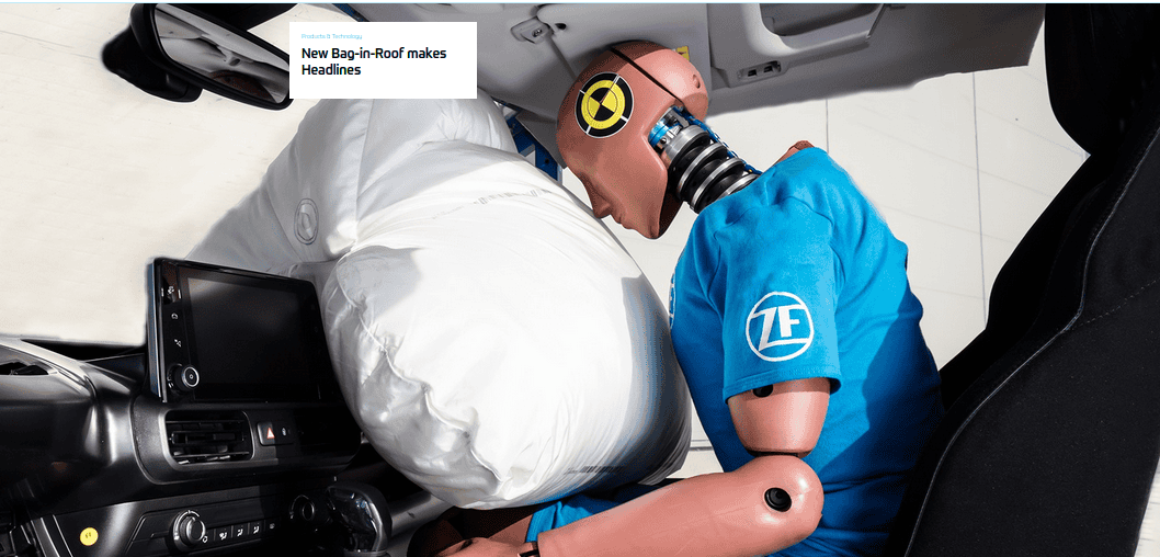

ZF is regarded as a pioneer of the Bag-in-Roof airbag, which helps to protect front-seat passengers of widely differing sizes in various seating positions. The roof-mounted airbag can be a valid alternative to traditional dashboard-mounted airbags.
The roof-mounted airbag (technically, Bag-in-Roof or BiR) celebrated its premiere back in 2014. In 2020 the application of the third BiR generation was launched.
https://passivesafety.com/nextlevel..._technologies/stories/bag_in_roof_airbag.html
first production vehicle to feature the innovative airbag was an SUV with suitably generous headroom: the Citroën C4 Cactus. The Bag-in-Roof was subsequently used in other PSA Group vehicles, such as the Citroën Berlingo, Peugeot Rifter and Opel Combo.
In addition to the wide range of vehicle types on today’s roads, roof-mounted airbags are suitable for future vehicle concepts such as robotaxis.
But that’s not all. The airbag module also reduces loads and stresses on the windshield. This interaction between airbag and windshield could generate stress on the glass under certain circumstances. Whereas, the roof-mounted airbag deploys in parallel with the windshield, reducing the risk of stress to the windshield.

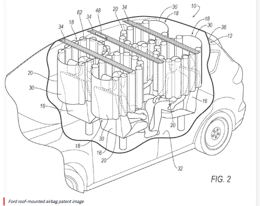

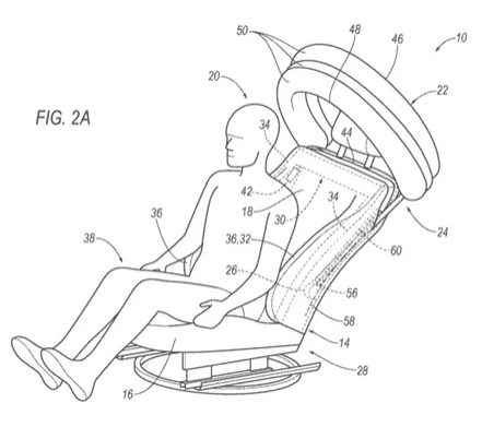

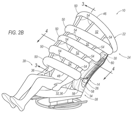

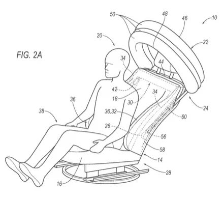

Ford Patent Filed For Seatback-Mounted Overhead Airbag
October 21, 2022
By Brett Foote
https://fordauthority.com/2022/10/ford-patent-filed-for-seatback-mounted-overhead-airbag/
Tesla Model 2 Airbag descending from roof/visor might be safer than airbags shot 150mph directly at your face 1689357547417
Tesla Model 2 Airbag descending from roof/visor might be safer than airbags shot 150mph directly at your face 1689357573535
Ford patents roof-mounted airbags
Ford has filed a patent application for roof-mounted airbags that would deploy from a vehicle's headliner and surround occupants for added crash protection.
November 20, 2022
By Stephen Edelstein
https://www.motorauthority.com/news/1137699_ford-patents-roof-mounted-airbags

Did you read my post? There have been roof/visor mounted airbags in some production cars since 2014.
There are even patents from Ford for airbags that deploy from back of seat that are still supposed to get deployed and catch person before they move too far forward.

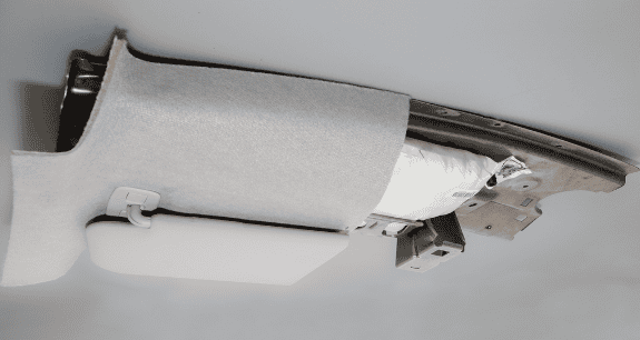

Looks like roof/visor deployed airbag would just cover up a dash display.
The airbag maker, ZF said the roof/visor airbag is also designed to not put too much pressure on windshield.
Mobilised | ZF Bag-in-Roof Airbag
Bag-in-Roof airbag is installed in the headliner instead of the dashboard and deploys along the windshield. With automated driving, it provide enhanced occupant protection for new seating position.
